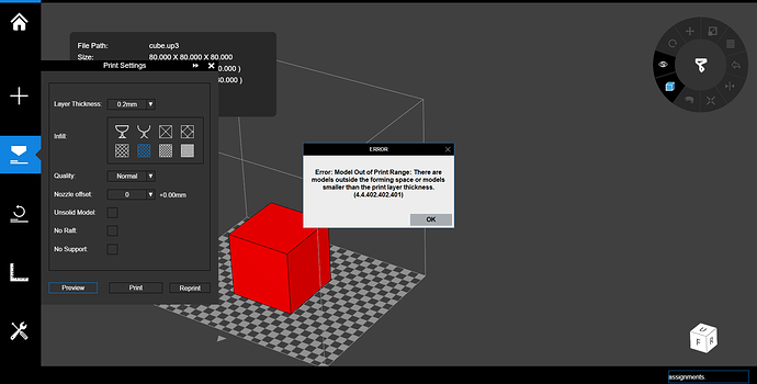

如果您得到:
Error: Model Out of Print Range: There are models outside the forming space or models smaller than the print layer thickness. (4.4.402.402.401)
Then remember to set the nozzle calibration height under the calibration menu on the touchscreen. New touch screen had a default value of 0.00mm, so of course, anything I try print is outside the possible print area. I probably would have known to do this if I went through the official documentation step by step I’m guessing.
解决了。谢谢@塔玛和@Jason-TT对于备件-非常感谢!
