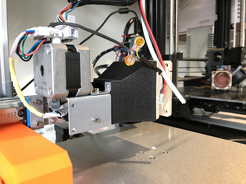

Hey guys,
You can give a try to this adapter here which was designed to optimize and improve the nozzle cooling when switching to a 60mm fan:
http://www.thingiverse.com/thing:2204439
With that you should be able to achieve large overhangs and bridging without any support.
Cheers

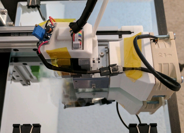

JanP 2017-4-13 01:48 edit
[quote][size=2][url=forum.php?mod=redirect&goto=findpost&pid=1375&ptid=192][color=#999999]hwarch post at 2017-4-9 04:16[/color][/url][/size] Hey guys, You can give a try to this adapter here which was designed to optimize and improve th ...[/quote]
Just installed your adapter, and I still feel quite a bit of backflow. I think the static pressure of the Noctua fan is just not strong enought to overcome the restricting diameter, and the obstruction created by the insulated heat block.
顺便说一句,如果你不能得到5 v版本的粉丝,you can try what I did. I installed the 12V version, together with a small DC-DC boost step up converter. Works like charm. Still need to decide if I want to design a new top cover that can house the converted, or just hot glue it in place.
The boost converted I had already, has adjustable output voltage. If you do this, I recommend that you get a fixed output version. They can be had for as little as $1.5 on ebay if your willing to wait on shipping from China.
hwarch 2017-4-13 06:59 edit
Just noticed ..What's that gap for in your adapter housing?
Edit: obviously just a reflexion ;)

Installed the Noctua Adapter, Im running Noctua fans on my other printers and damn they are quiet! :)
I still havnt been able to use my printer though, extruder motor doesnt move at all.. have checked all cable connections so I assume its the stepper card. Awaiting answer from support...
Printed in Nylon Carbon Fiber filament!
I finally got my Noctua 5v 60mm installed and was able to print out a 20x20x20 test cube. A 3DBenchy is in progress to do some light weight bridge testing.
https://goo.gl/photos/YmRqo9Ck8ofUpCtV6
Its about as quiet as its going to get at this point. I'm happy!
Hi all,
i just installed the 5V noctua fan, withthisadapter (thanks for providing it!). I didn’t use the omnijoin because i couldn’t fit the noctua’s own connector in the omnijoin connector and anyway i didn’t see the point, so i joined the wires directly to the wires (after cutting them of course) of the original fan, using the yellow smartlocks provided with the fan (also shown above in a previous post).
The noise is way down, and i didn’t do an overhang test but i did print a benchy and it looked exactly the same as before.
So definitely a success!
